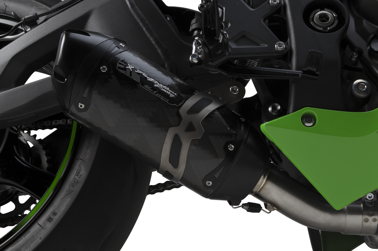

                #22
                2016 kawasaki zx-10r two brothers exhaust
