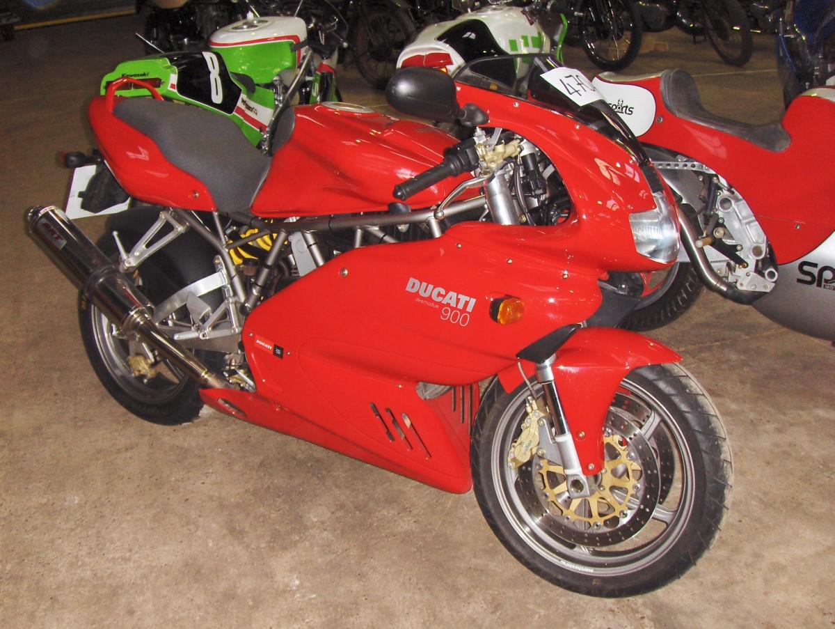

      ‘More than any other Ducati, the 900SS recalls the roots of Bologna’s success and rediscover a niche in the marketplace long empty.’ Cycle magazine. The arrival of Ducati’s all-new, 8-valve, water-cooled v-twin in the late 1980s led to a comprehensive restructuring of the range, the appearance of this World Superbike contender creating a niche for a super-sports roadster. This gap would be filled by the 900SS that arrived in 1991, reviving one of the great model designations from the Bologna factory’s past. The newcomer used a development of Ducati’s long running ‘belt drive’ v-twin motor that had first appeared in 1978 in the Pantah 500. Air-cooled and 2-valves –per-cylinder, the 80bhp 900SS was simpler, easier to maintain and, of course, less costly than the 851 Superbike. In style though, it gave nothing away to its more exotic cousin, having the same ‘trellis’ frame as the 851 – now established as a Ducati trademark. Handling was, needless to say, exemplary and while ultimate performance was down on that of the superbike, with a top speed of 140mph the 900SS was more than fast enough for the majority of riders in everyday conditions. 750SS and 600SS versions followed soon after. A major success for Ducati, the 900SS underwent progressive development over the years and remained a fixture of the range until 2003. This pristine 2002 example has covered only 6,121 miles from new and comes with a full set of (4) MoT certificates, the current one expiring in May 2008. The machine has been sold by D & K Motorcycles of Newcastle-under-Lyme more than once, being freshly prepared on each occasion, and comes with their (copy) service history indicating that the cam belt was last changed on 1st November 2006 at 5,157 miles. In addition, the machine is offered with the aforementioned MoT certificates, Datatag guide and Swansea V5C registration document.
      As mentioned in a different thread, I have this wonderful bike now for sale. [ATTACH] [ATTACH] Asking price is £5100. (Shipping at additional cost)...

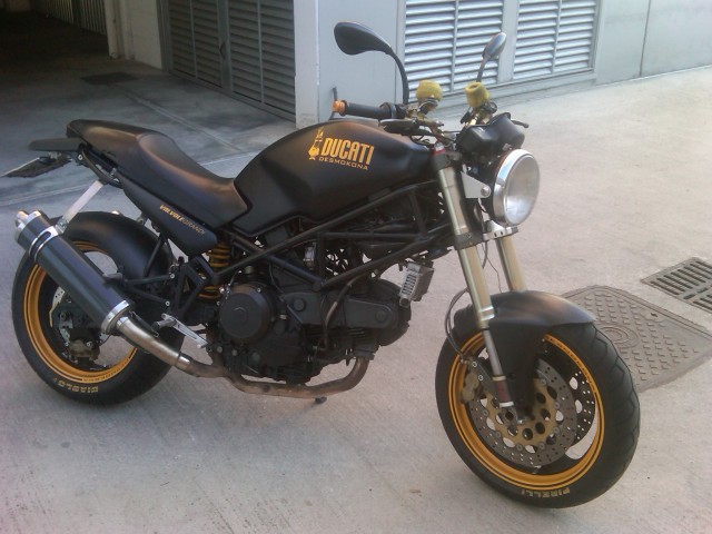

                              Ma certo. E' un Monster 900 del '99, che originariamente aveva un motore a valvole piccole:
                              Le foto risalgono ad una delle prime uscite, nel frattempo è arrivata la sella rifoderata ed è arrivata la pompa freno radiale Braking da 19mm.
