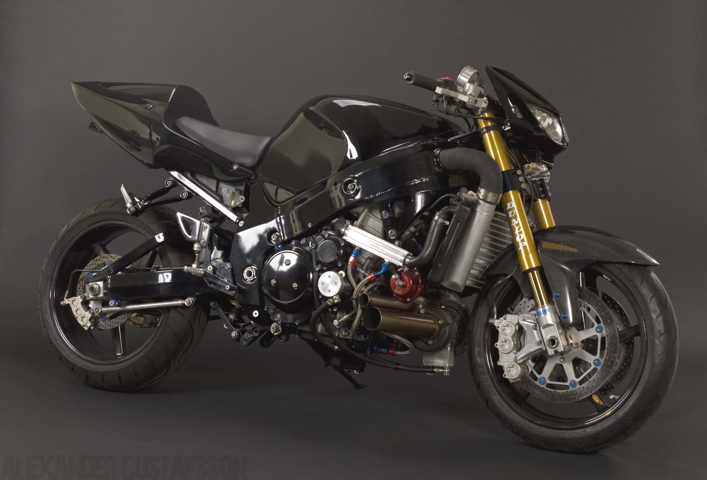

                  TECHNICAL DATA:
                  ENGINE:
                  • 1298cc
                  • McXPRESS racing turbo kit with everything + much more & bigger
                  • McXPRESS port & Gas Flow Cylinder Head
                  • JE low compression pistons
                  • Steel rods
                  • KENT cams, high performance camshafts
                  • LAMINOVA water cooled oil cooler
                  • NBN HYDRAULIC steel clutch line
                  • TTS gearbox with 13% higher speed on 5 gear and 15% higher speed on 6 gear
                  • Front sprocket, 17-19
                  • Rear sprocket, 32-38
                  BODY:
                  • SUZUKI GSX-R1000K2 fuel tank
                  • ANDERSSON TURBO SYSTEM Special made race seat
                  • SUZUKI GSX-R1000K4 rear light
                  • DERBI SENDA front light
                  • QB CARBON front Mudguard, vented
                  • Carbon heel plates
                  CHASSI:
                  • ANDERSSON TURBO SYSTEM Special made frame
                  • ?HLNS R&T special made front forks
                  • ?HLINS rear damper
                  • ?HLINS steering damper
                  • ISR monster dual 6-piston radial-mount calipers in front
                  • ISR 6-piston caliper in rear
                  • ISR dual full floating 320mm discs in front
                  • ISR full floating 240mm disc in rear
                  • ISR radial master cylinder and lever/front brake
                  • ISR clutch lever
                  • ISR race brake pads in front and rear
                  • NBM hydraulic steel brake lines in front and rear
                  • HARRIS PERFORMANCE adjustable yokes triple bolt bottom fixing
                  • HARRIS PERFORMANCE footrest kit with adjustable foot peg position
                  • RENTHAL handlebar
                  • BST carbon fiber wheel, front and back

                    E' la sua... c'e' la lotteria per vincerla... io ora mi acchiappo qualche biglietto
                    mi piace troppo...? la streetfighter d'eccellenza
                      Busa turbo.
                      Freni full ISR e cerchi carbonio.

                          Lottery : Hayabusa Turbo 500hp | Ghostridermovie.net
                            quella moto detiene anche il record di velocit? su una sola ruota
                              E' la Busa turbo di Ghostrider.
                              Non credo che abbia mai dovuto sostituire lo pneumatico anteriore
