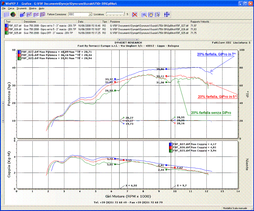

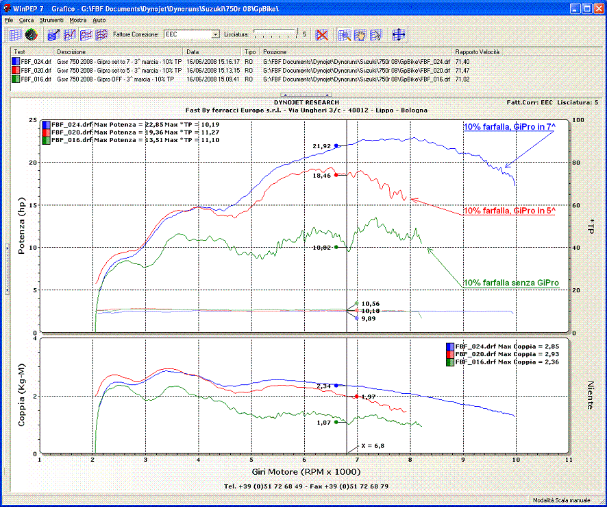

RAGAZZI HO MONTATO LA GIPRO E HO PROGRAMMATO LA 6a PER GIRARE PER STRADA COME MI HA DETTO IVAN DI FERRACCI, E LA MOTO E' DIVENTATA FANTASTICA. TIRA SUBITO AI BASSI E IN TUTTE LE MARCE E' DIVENTATA REATTIVA. HO PROVATO ANCHE A PROGRAMMARE ANCHE LA 5a, MA E' PIU' CHE ALTRO DA PISTA PERCHE' BISOGNA GIRARE MOLTO ALTO CON I GIRI, MA ANCHE LI IL MILLONE DIVENTA UN MOSTRO.
